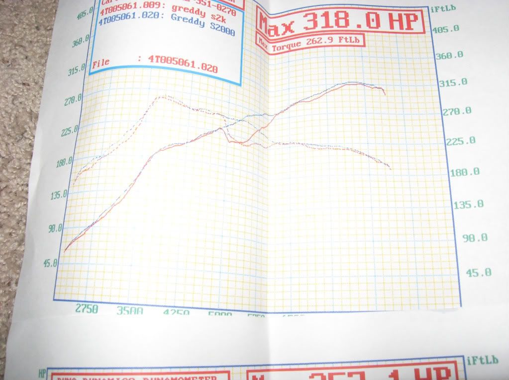

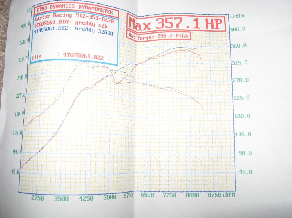

I gotta chime in here. I know a ton for pple talk crap about the greddy kit but damn gents just look at the TQ curve that can be had for 4k Everything included other then oil and plugs (even thou I would wideband and boost gauge the lil sucker)

Greddy is really not a bad kit if your fine with around 300hp its just that it dosen't have the chance to go much higher than that where as a lot of other turbos skys the limit lol.

on S2ki isn't there a dude running the kit getting about 350 out of it. and the real big plus to the kit is full boost at 3500rpms. this kit is a jewel

I have a greddy kit with arp head studs and aem ems, and I tuned in at 357.7 whp on a dyno dynamics dynometer which reads 15-20 percent lower than dynojet machines putting it at 405ish on a dynojet machine. It's running 14 psi on high boost, and 10psi (making 318 on that machine or 370ish on a dynojet)... The car absolutely screams, and with such a small turbo (18g) it spools up nicely. With that much power with a sc you would never get traction...
just my 2 cents..
here's the dyno sheets:
High Boost
Low boost

So this thread is amusing to say the least. Good job beating that highest greddy hp by alot. That turbo is not even close to capable of 405 whp look at the compressor maps they tell the story. I have no idea how anyone could get 350 out of it.
