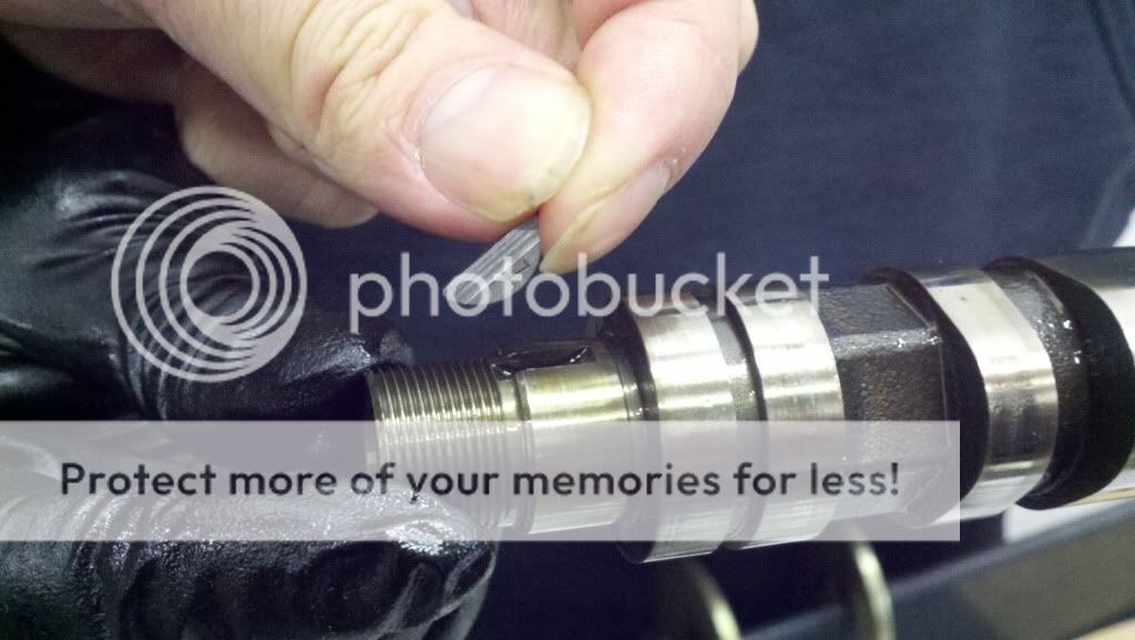

Put the new clutch in yesterday, pressed the old bearings off and new ceramic bearings on. Still waiting for the billet impeller to show up along with the EMS and woodruff keys.

The new wheel showed up, supercharger gear case is back together with the new bearings in. Cam keys also showed up, EMS should be here shortly.
