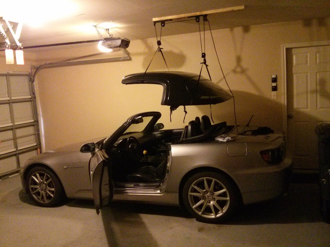

I really like this design and finally decided to give it a try. The parts just arrived today but I will still need a piece of 2x4, some white paint, and some decent screws to mount the 2x4 to the rafters.
EDIT:
I finally got around to properly mounting the hoist to the rafters via a support beam and have successfully performed a test hoist on the hardtop. The support beam is extra long in case I want to install an electric winch in the future.
The webbing I am using applies pressure to the window seals so I am rethinking how the front part of the hardtop will be supported. Additionally, the automatic lock on the rear pulley is a great safety feature but a total pain when the top is up since the rope needs to be pulled the other way to disengage it and lower the top. Some rethinking there is required as well...
